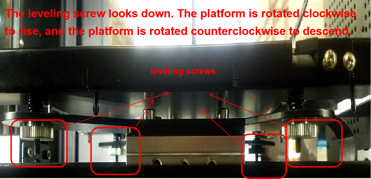

When the printed model has warping and other issues, it may be due to the levelness of the printing platform not suitable.
Following is the adjustment method and the method of replacing the leveling screw.
