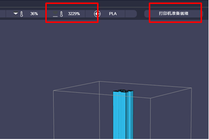

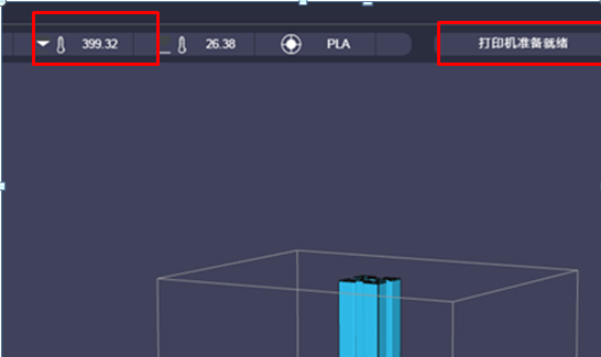

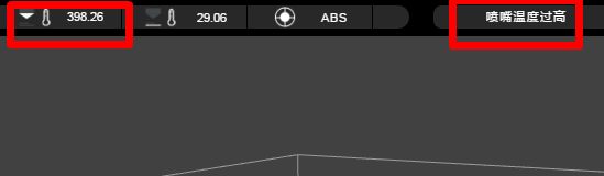

Software reports nozzle high temperature error
Printing stops and reports nozzle high temperature error
Platform automatically heats up after initialization
Software reports platform high temperature error when loading model
Please follow this troubleshooting guidance for further checking.
Cause | Solution | Remark |
Nozzle (nozzle plate, temperature control components, etc.) |
Turn off the power, remove and replace the nozzle PCB board Turn off the power, remove the nozzle, and replace the integrated liquefied gas Turn off the power and replace the nozzle assembly |
It is recommended to replace the nozzle assembly |
Nozzle is not heated, fan doesn’t run when the motor is turned on |
Turn off the power and replace the nozzle PCB adapter board Turn off the power and replace the nozzle PCB board |
FFC-platform heating wire false connection
Re-plug or replace the FFC-platform heating cable | |
26P adapter cable short circuit | Re-plug or replace the 26P color cable | |
Mainboard damaged
Turn off the power and replace the mainboard |
