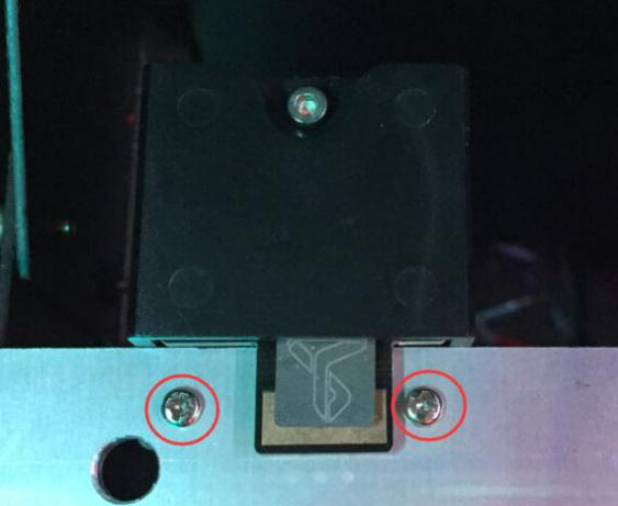

1. Screw off two bolts on aluminum board.

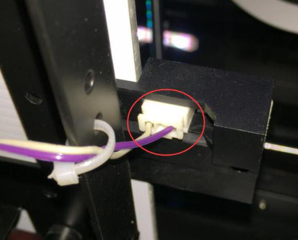

2. Unplug the sockets on bottom to uninstall the Height Detector.

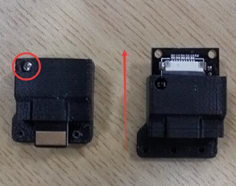

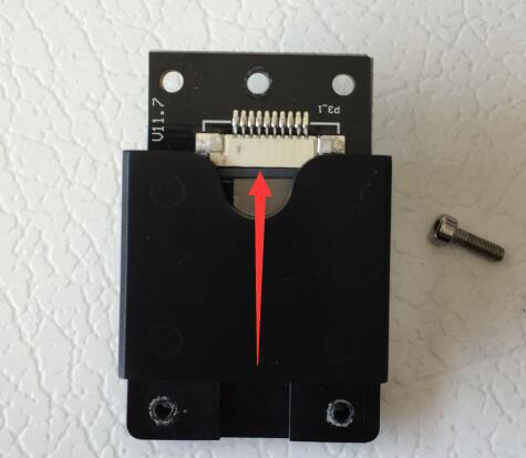

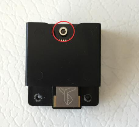

3. Remove the bolts in red mark and push out the detector by following red arrow.
Attention:
Please follow the below picture for the old version.
