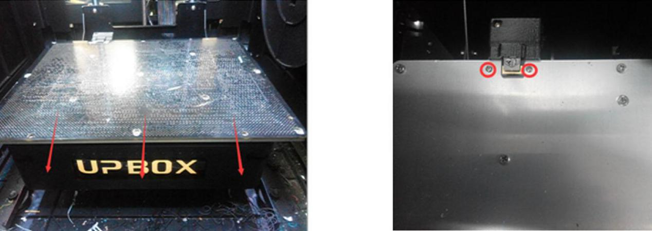

1. Take out the cell board.(Press and pull the cell board from the plate)

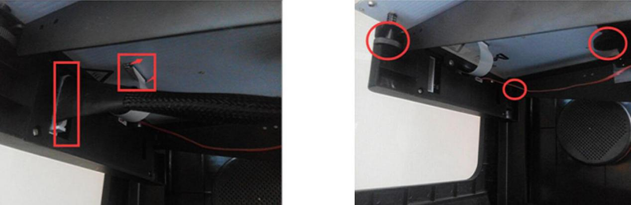

2. Screw off the bolts for the height detector by cross screwdriver.
3. Unplug FFC-plarform cable and CFC-LED cable.
4. Anticlockwise screw off the three adjusting bolts on aluminum plate to take the
plate down.
Attention
Adjust three bolts to keep level of platform after installation.
