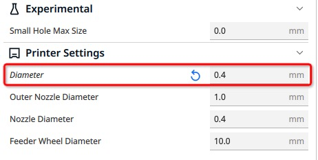

4. The filament diameter option in Printer Settings is very critical for correct extrusion flow. Set it to 0.4 should be ok, remember to adjust this value and sync other options when adding new extruders.

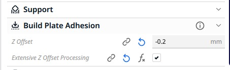

5. Z Offset value may need to determined by test prints, -0.2mm should be a good start.

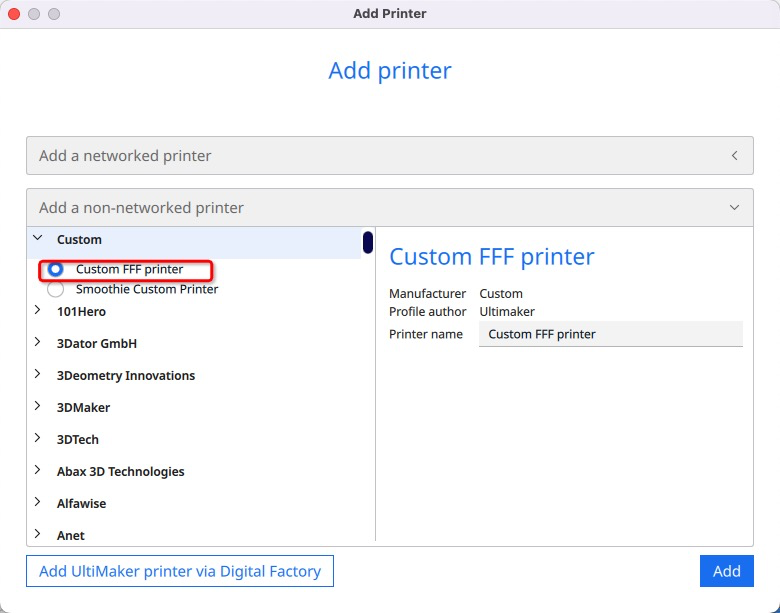

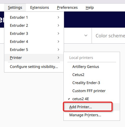

3. Add a custom printer
Choose non-ulitmaker printer=>custom printer

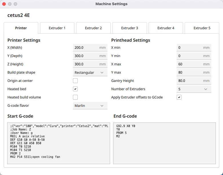

Setup the printer as following:
Extruder set to use 1.74mm filament and 0.4mm nozzle.
Custom Start and End Gcodes in machine setting:
Start G-code:
;{"ver":"100","model":"Cura","printer":"Cetus2","mat":"PLA","thick":"20","fill":"0","time":"18","weight":"29"}
;Job Name: Z
;User Name: g
M83; A axix relative
DEF G10 G0 A-30 B-30
DEF G11 G0 A30 B30
M104 T0 S210; adjust temp (S value) for different material
M104 T1 S210; adjust temp (S value) for different material
PROM 2
M42 P14 S511;open cooling fan
End G-code:
G92.9 X0 Y0
T0
PROM 5
M2

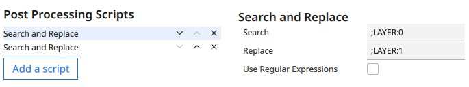

5. Gcode post-processing script need to be added in Cura:
search and replace (sequence sensitive):
1.
Search:;LAYER:0
Replace:;LAYER:1
2.
Search:;LAYER:
Replace:M73 L
6. [Important] Plugin Settings:
Filament Diameter should set to 0.4mm in printer settings
Z Offset set to value between -0.2mm, this value need to be determined by test print.
