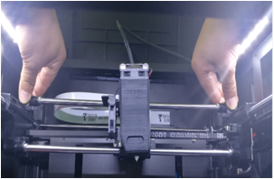

- Turn off the power and re-initialize, check if the Z-axis motion is smooth, if there is a stuck or abnormal sound

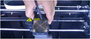

- Turn off the power and re-initialize, push the Y-axis back and forth to check if the X-axis motor pulley and the connecting rod pulley have glue failure
- Turn off the power and re-initialize, hold the nozzle and nozzle holder by hand, push Y-axis nozzle holder to the left and right to check if the Y-axis motor pulley has glue failure

X-axis test method
Y-axis test method
